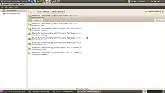

Look at the video; the iPhone is supposed to appear as a photo collection of some sort but nothing happens with my iPhone! I have installed and upgraded all of the libimobiledevice versions.

I have added this PPA, I have done all of the sudo update and upgrade. but my computer doesn't realize that my iPhone is connected, whish isn't related to libimobiledevice.
