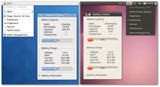

You can try Battery Status 0.1
Battery Status is a project for GNOME, that shows information about laptop battery state. It has some additional features, so usual icon of GNOME Power Manager can be removed from Notification/Indicator Area. Battery Status doesn't rely on GNOME Power Manager directly, but counting on presence in system for some useful integration with it.
enter image description here Features:
Using the Battery Status applet, the user can access:
  • Battery Status dialog
  • Power Statistics (provided by GNOME Power Manager)
  • "Show" setting
  • CPU frequency scaling (provided by gnome-applets/cpufreq-applet)
  • Power Management preferences (provided by GNOME Power Manager)
Add the ppa ppa:iaz/battery-status to your software sources (here's how to do that) and install battery-status from the software center .
You can run it as an indicator using the following command:
/usr/lib/battery-status/battery-status --indicator
