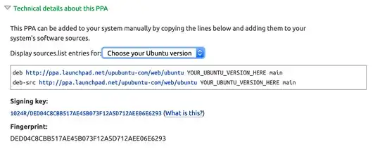

Yes. The PPA page on Launchpad has the information needed in "Technical details about this PPA":
Select the version from the drop down and it will show you the exact lines to copy. For example, for 12.04 (precise), you can add the following two lines to your sources.list file, or a new .list file in /etc/apt/sources.list.d:
deb http://ppa.launchpad.net/upubuntu-com/web/ubuntu precise main
deb-src http://ppa.launchpad.net/upubuntu-com/web/ubuntu precise main
You then need to run the following, using the key fingerprint:
gpg --keyserver subkeys.pgp.net --recv DED04C8CBB517AE45B073F12A5D712AEE06E6293
gpg --export --armor E06E6293 | sudo apt-key add -
Or use a web interface like http://keyserver.ubuntu.com/ to get the key manually, and then add it using sudo apt-key add path/to/file.
