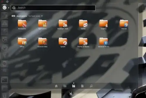

This doesn't change the dash itself, but it does present you with a categorized view of installed applications. You can access it directly by using super+a, or you can just open the dash and tap tab to switch to it -- or click the App lens icon at the bottom of the dash. Anyway, it'll look like this:

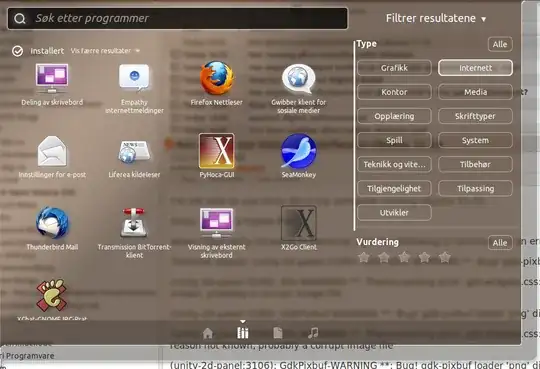

You could try taking a look at the Unity Bliss Lens, which puts applications into category folders in the dash.
Screenshot of Unity Bliss Lens
Instructions for installation:
  1. Download the package from https://launchpad.net/unity-lens-bliss by clicking the green button on the right side of the page.
  2. Extract the package into your home folder.
  3. Run the following in a terminal:
    cd unity-lens-bliss-0.1.3
    ./configure –prefix=/usr –sysconfdir=/etc
    make
    sudo make install
Log out and back in to see it in the Dash.
(Source)
