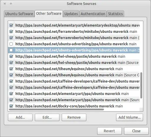

After you install a PPA this PPA -is- included into Ubuntu Software Center. You can see all the available packages for that PPA. They are included in software sources as shown here:
but there is also a list of PPA's inside USC (I believe it is under installed).
