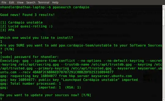

If you are having a hard time figuring out the correct add-apt-repository command to run, someone has created a script called ppasearch to make this task easier.
An explanation of how to use this script is available on the 'What are PPAs and how do I use them?' community wiki.
ppasearch screenshot
