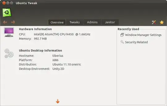

Home screen
The Ubuntu-Tweak Home screen

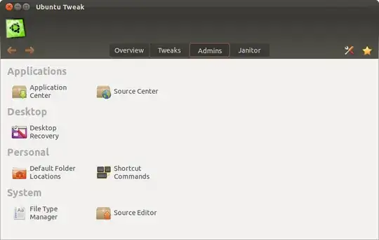

Admins
The Admin panel

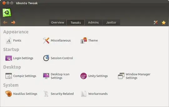

Tweaks
The Tweaks panel
