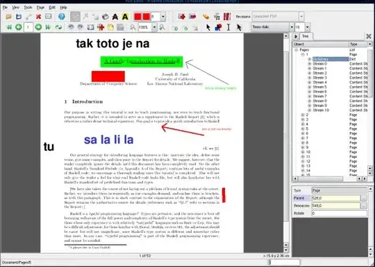

There is another app out there called PDFEdit - its hosted on source forge. Source Forge Project Page - However this doesn't help because it doesn't the functionality you require
Text Editing in PDFEdit
