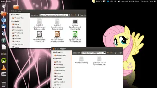

.odt and .odb files do not have an icon in Nautilus and some of my older documents are missing their thumbnails, all of which are either .odt or .odp.
I just purged and reinstalled LibreOffice today... could this be the reason why?
I am on Ubuntu 11.10, using LibreOffice 3.4 340m1(Build:402) that comes by default in the repos.
Here's what I see for these formats:

To have LibreOffice documents in Nautilus while using Ubuntu 11.10 you need to install an extension to it since those are not supported by default.
The only one I know of is ooo-thumbnailer from this PPA, it can be installed using these commands in a terminal:
sudo apt-add-repository ppa:flimm/ooo-thumbnailer
sudo apt-get update
sudo apt-get install ooo-thumbnailer
When its done installing you should need to log off or restart Nautilus with nautilus -q.
It should be safe to use this PPA but you should always remember there are no warranties using PPAs.
