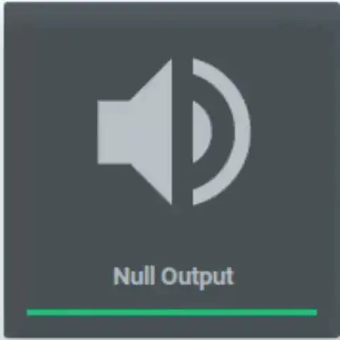

Now when you press the volume keys, the volume will change in increments of 2:

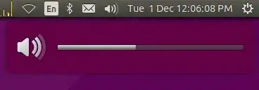

Much more elegant, and it works with the OSD volume notifications.
