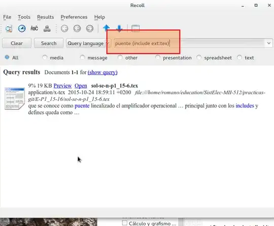

For a graphical solution (and a more powerful one, when it works correctly --- which is most of the time) is to install recoll.
You will need to install it using the PPA --- look at the download instructions (scroll down to the part for Ubuntu systems).
After having installed it, choose a kind of indexing (I do mine overnight for this still unresolved problem --- which is probably due to some strange configuration in my system), you have a very powerful tool to find files in your system (even contents of files like ODS spreadsheet or compressed archives ort similar things).
In your case simply call the Recoll interface:
recoll interface
(I used "puente" as the search term because I have no methyldopa around ;-)) --- the search is written in the recoll query language..

I suggest to use Recoll for an indexed search with a graphical interface and a preview functionality! It is in the official repositories, easy to use and very powerful.
