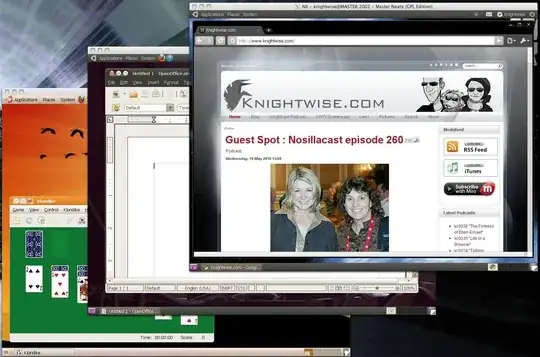

What is NeatX?
Neatx is an Open Source NX server, similar to the commercial NX server from NoMachine. If you're not familiar with NX, these links might help:
random pixs of the web
