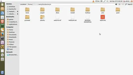

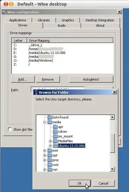

After you mount the ISO or the disk with any tools or commands which you prefer, start Configure Wine create a new Drive mapping. Click Add, browse the path and select OK. Here, I've mapped Ubuntu 13.10 i386 DVD to drive letter e: in wine (g: is for my Flash Drive).
cinfigWine
Then you can browse the iso or disk in the $HOME/user/.wine's dosdrives directory.
dosdevices

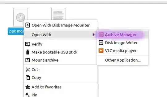

If you don't want to mount iso in Ubuntu, however want to mount iso in Wine only.
Right click on iso file, select Open With -> Archive Manager. Unpack iso content into new folder e.g. iso. enter image description here

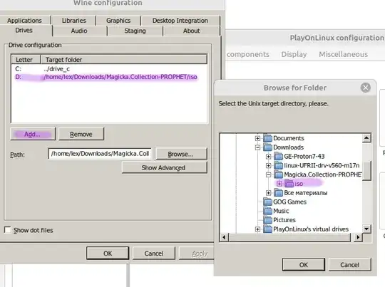

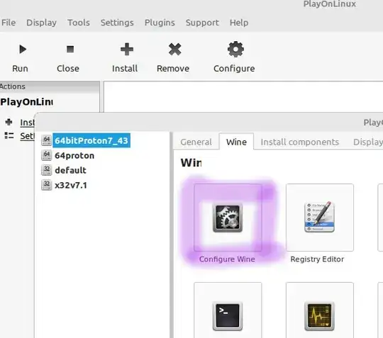

In Wine go to Configure Wine select Drivers tab. Click Add... to add new driver, select any letter. Select already created driver, click Browse... and specify extracted iso folder path.

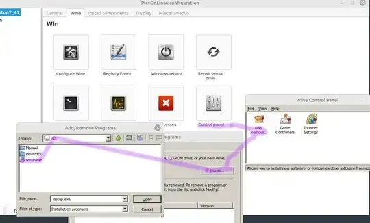

Next open Control panel select Add/Remove Programs click Install... specify some .exe file from mounted drive.
