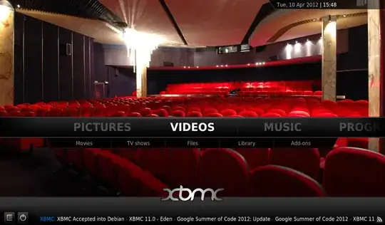

For Ubuntu 12.04 & 12.10 you can use the following PPA from here: XBMC Nightly : Nathan Rennie-Waldock
sudo add-apt-repository ppa:nathan-renniewaldock/xbmc-nightly
sudo apt-get update
sudo apt-get install xbmc
I recommend this one because:
  • No need to compile anything
  • Does not have dependencies issues with other packages
  • Solves an audio problem I was having with HDMI
  • Performance is MUCH better when having many movies (More than 900+ Movies)
  • Searching for Movie Data (Cover Art, Actor Information...) is MUCH faster
  • Loading and Reading are better
  • Respects Widescreen resolutions
  • Sound quality is better
  • BAD - It will appear almost daily to update since it is a Daily PPA which is why I recommend that, after downloading it the first time, Disable or ignore the PPA for a week at least. No sense in updating it everyday.
This are the problems I was having with XBMC that came with 12.04. This is because most of this problems are fixed in the Git repository but not yet applied to a stable release. This version however is very stable for me. Tested with 900+ movies, 8000+ songs and 17 TV series. Downloaded cover arts for all, lyrics, subtitles, etc.. No problem, not even one. The remote controller for android also worked perfectly.
