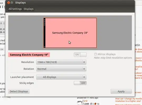

Open your systems settings from top panel right corner wheel.
in your system settings look at monitor settings . there you can set your monitor resolution from available resolutions .

Maybe this will help
maybe this will help. Open displays from settings and adjust the resolution from drop down menu
