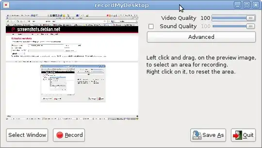

gtk-recordmydesktop install gtk-recordmydesktop
Adds an easy to use graphical icon on the GNOME toolbar to make a pleasure use and configure the audio and video capture and screencast application recordMyDesktop.
As mentioned at 20.04: Can't install gtk-recordmydesktop and on the package search, the package is not available on the main repository anymore, and sudo apt install gtk-recordmydesktop fails. I'm not sure why the http://apt.ubuntu.com/p/gtk-recordmydesktop link seems to work, maybe it installs an older version. But this indicates that the software is not being actively supported.
recordmydesktop
This is the non-GUI backend of recordmydesktop, and it is still available in 20.04:
sudo apt install recordmydesktop
recordmydesktop --on-the-fly-encoding
This will record until you stop the program on the terminal e.g. with Ctrl + C.
--on-the-fly-encoding encodes the output immediately; without it you need to wait for a possibly long time at the end for the encoding to be done. I haven't seen any significant downsides to that option yet, likely it will just take a bit more of CPU resources, but it is generally worth it.
It should be able to do everything that gtk-recordmydesktop does, but it is a bit harder to learn as you have to deal with the command lines.
You can set a stop recording shortcut e.g. with:
recordmydesktop --stop-shortcut=Control+s
You can select to record a single window as shown at: How can I get the value of Window ID?
recordmydesktop --windowid `xwininfo | grep 'id: 0x' | grep -Eo '0x[a-z0-9]+'`
This will allow you to first select the window with a mouse click, and it starts recording after you click.

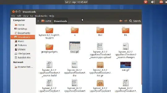

I like Byzanz; it records your activity as a GIF file.
It's pretty light and works well, especially for putting a shorter screencast on a webpage or in an email.
You can either get it from the PPA (might have a more up-to-date package but is 'unsupported'):
sudo add-apt-repository ppa:fossfreedom/byzanz
sudo apt-get update && sudo apt-get install byzanz
Or you can get it from the official Ubuntu repositories by clicking the button below:
Install Byzanz
For further information:
How to create animated GIF images of a screencast?

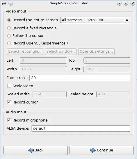

Simple Screen Recorder
SimpleScreenRecorder is a Linux program that I've created to record programs and games. There are programs that can do this, " but I wasn't 100% happy with any of them, so I created my own "
My original goal was to create a program that was just really simple to use, but as I was writing it I started adding more and more features, and the result is actually a fairly complex program. It's 'simple' in the sense that it's easier to use than ffmpeg/avconv or VLC :).
For Ubuntu versions 12.04 - 16.10 it is not in the standard repositories and can be installed with the following:
sudo add-apt-repository ppa:maarten-baert/simplescreenrecorder
sudo apt-get update
sudo apt-get install simplescreenrecorder
# if you want to record 32-bit OpenGL applications on a 64-bit system:
sudo apt-get install simplescreenrecorder-lib:i386
For Ubuntu versions 17.04 - onwards it is included in the universe repository and can be installed by:
sudo apt-get update
Here is a UI preview:

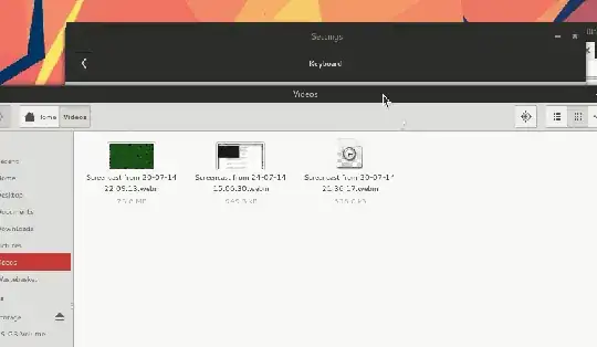

GNOME built-in desktop recorder
Gnome 3 already seems to have a very simple thing to do record Screencasts - you can assign what shortcut it uses in Keyboard settings. It records the entire screen, and records directly into a webm file (a fairly widely used format) into XDG_VIDEOS_DIR - by default "$HOME/Videos".
  1. By default, to start recording, press Ctrl + Alt + Shift + R. You'll see a circle displayed on top right corner to indicate recording is in process.
  2. To Stop recording, press Ctrl + Alt + Shift + R again.
Source: Screenshots and screencasts on Gnome Help page
example screencast
The above image should be animated - if you have animations disabled it won't work. Click to view the file
If you want to convert the image to a animation, this answer on Superuser is very helpful - the best method is to basically:

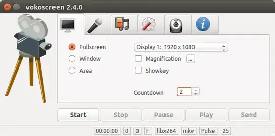

Vokoscreen
A new screencasting tool for Linux
vokoscreen screenshot
Installation
Since Ubuntu 20.04 there's a package:
sudo apt install vokoscreen-ng
Previously you needed a PPA:
sudo add-apt-repository ppa:vokoscreen-dev/vokoscreen # For latest version
sudo apt update
Alternatively, using snap:
snap install vokoscreen-ng

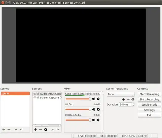

Open Broadcaster Software (OBS)
screenshot
But this works really well. The main reason why I use it is because I can record both my microphone AND monitor output with ease.
Plus you can stream to Twitch if you'd like.
sudo apt-add-repository ppa:jon-severinsson/ffmpeg
sudo apt-add-repository ppa:obsproject/obs-studio
sudo apt-get update
sudo apt-get install ffmpeg obs-studio
If you don't want to add the PPA you can also download the deb file and installed with sudo dpkg -i <debfile>.
The benefit of OBS is that you can preset many recording options like screen recording and webcam. Whenever you need to start recording just select the preset recording option and start recording. Along with that while screen recording you need not to select windows/ grab screen every time. It have option to select whole screen or just a specific area of page on google-chrome or Firefox or libre-doc. In this case it just keep on recording that specific selected area of that application irrespective of what you are viewing on your screen and even if you resrat. You can see real time preview. This saves a lot of time and effort.

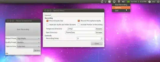

Tibesti
Tibesti Screencaster is a program for Ubuntu that allows you to record your screen and your microphone and/or audio out sounds.
Screenshot from OMG!Ubuntu!
To install add the PPA ppa:ackondro/tibesti (How to add a PPA) and then install tibesti from the software center.
Alternatively, open a terminal and paste:
sudo add-apt-repository ppa:ackondro/tibesti
sudo apt-get update
sudo apt-get install tibesti

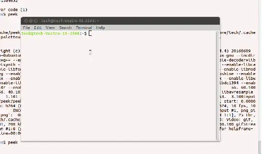

Check out Peek. You can record screencast of a selected region and save it as GIF.
Recording screen using peek
You can install the latest version of Peek on Ubuntu from its PPA.
sudo add-apt-repository ppa:peek-developers/stable
sudo apt update
sudo apt install peek

Here's an example:
Animated GIF screenshot

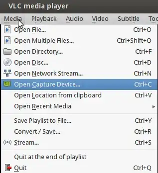

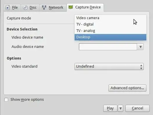

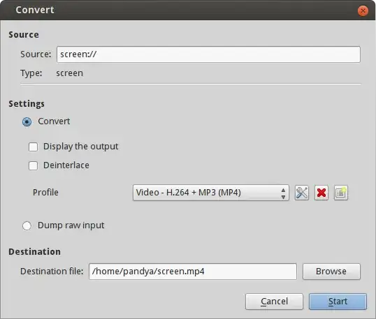

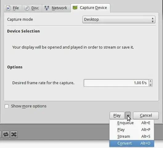

You can use VLC as follows:
  1. Launch VLC media player and select Media > Open Capture Device:
  2. Set Desktop at Capture mode:
  3. Enter desired frame per rate for the capture and select Convert at bottom:
  4. Provide path to the file to which you want to save your screen capturing by Browse button and click on Start to start recording:
  5. Click on Stop button when you finish.
You'll get the screen recorded/captured in the file.

Ubuntu 18.04/GNOME 3 have a built-in feature of recording screen for 30 seconds. Ctrl + Alt + Shift + R to start or stop recording.
Videos will be saved in WebM format in videos folder
You can increase it by installing dconf Editor from Ubuntu Software. Follow these steps:
  1. Open dconf-editor and type screencast, this will let you jump to schema org.gnome.settings-daemon.plugins.media-keys.
  2. Edit the 30 of max-screencast-length key to required value (set it to 0 to make it stop when you hit Ctrl + Alt + Shift + R to stop recording)
You can also edit the shortcut if you need to change.

OBS Studio worked for me.
It has the most advanced features I've seen - can record your entire screen or just a window, and can also be used for streaming your screen and other stuff I didn't even use.
Warning: It's only for advanced users.

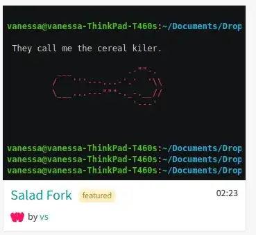

asciinema
A fast/lightweight way to record the terminal:
Forget screen recording apps and blurry video. Enjoy a lightweight, purely text-based approach to terminal recording.
  • Install: sudo apt install asciinema
  • Record: asciinema rec
  • Stop: Type exit or hit Ctrl+D
Then will give you the option to upload (public or private) or just generate the file on disk.
screenshot
