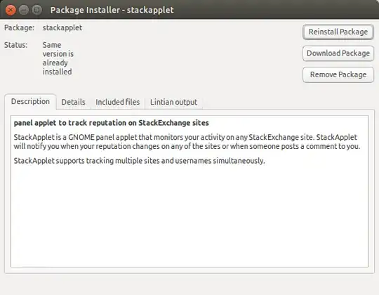

However if you like GUI apps, I would recommend GDebi to install deb files, although if something goes wrong it will recommend you to open a terminal and do a sudo apt-get install -f.
To install GDebi: sudo apt-get install gdebi. Then for every deb file you have, right click and select Open With -> GDebi.
And a screenshot: enter image description here
