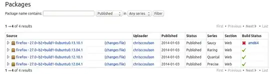

And to add on all the current answers here, I would like to add 1 more reason that I keep having with the Firefox beta PPA. (Though the other answers here are most likely the correct solution for you)
When trying to upgrade a package by adding a new PPA, if the package doesn't get upgraded you can check on launchpad to make sure there is a successful build that is available for your version of the OS.
For example I have added the PPA for Firefox beta.
sudo add-apt-repository ppa:mozillateam/firefox-next
My system is Ubuntu 13.10 x64. So checking the PPA on launchpad (https://launchpad.net/~mozillateam/+archive/firefox-next/+packages), it seems that, currently, the build for that specific Ubuntu version on the 64 bit architecture failed. Thus the package did not get upgraded and I got stuck with the release version of Firefox instead of the beta version.
Failed build for Raring amd64
As long as the PPA is on launchpad, you can always do this check.
In your case, you need to check https://launchpad.net/~yorba/+archive/ppa/+packages.
Currently there doesn't seem to be any failed build, but this answer can be helpful for future & similar problems.
