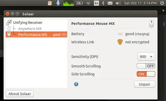

I would like to complement Lekensteyn's answer by including a feature I did not know about. I have a Logitech Anywhere MX mouse and when the batteries were almost out, I got the following message:
So the Unifying receiver is not only supported by it offers (Depending on the device) several features like the image above. This image was with Ubuntu 12.10

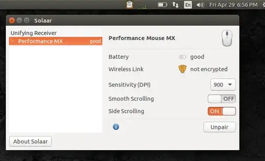

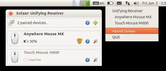

On Ubuntu 14.04 with version 0.9.2 you can see the following:

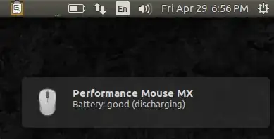

  • A panel icon (Battery icon) that measures how much battery the wireless mouse has left
  • A menu (After clicking the battery icon) that shows all mice that have been paired
  • Clicking on the Unified Receiver option will reveal a second window that shows each mouse individually with several options.

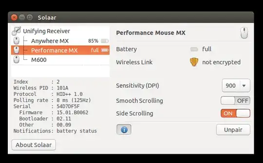

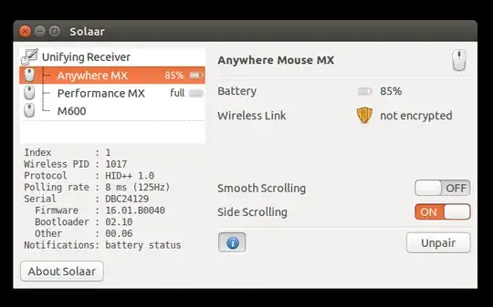

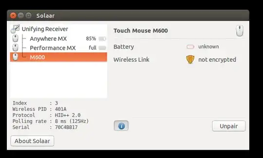

Here are some images of several Logitech mice working together with one unified receiver:
Solaar offers an easier way to know how much battery you have left, how much time you have let, which mouse you are using and more. It also offers special features like detecting if the battery is charging:
The following 2 images are from Ubuntu 16.04 64-bit With Solaar:
