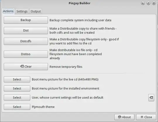

Pinguy Builder is a tool that works up to Ubuntu 16.04:
Version 3.* works with *buntu systems 14.04 (May also work with 14.10)
Version 15.10 works with *buntu systems 15.04 & 15.10
Version 4.* works with *buntu systems 16.04
Its description looks quite interesting:
The Pinguy Builder will create a installable ISO of your current system. You can then burn that ISO to a USB using something like Unetbootin or just burn the ISO directly to a DVD. The DVD/USB can then be booted from a PC.
