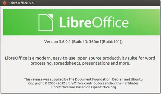

Install / Upgrade to LibreOffice 3.6
To get started, press Ctrl – Alt – T on your keyboard to open the terminal. When it opens, run the commands below to add its PPA.
sudo add-apt-repository ppa:libreoffice/libreoffice-prereleases
Finally, run the commands below to upgrade your system including LibreOffice.
Enjoy!
sudo apt-get purge libreoffice-core
sudo apt-get update
sudo apt-get install libreoffice
These four lines in terminal to remove your current LibreOffice, and install the new one. It says it will install LibreOffice 4.0, But I got 3.6.0.1 instead, which happens to be the newest stable version I'm aware of.
