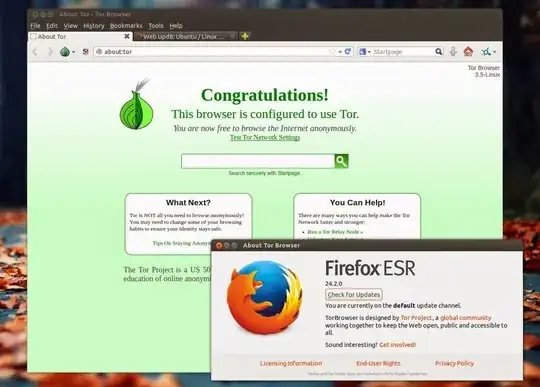

Why use wine when you have a native app for that? Based on Firefox...
Tor (anonymity network)
tor-browser-3.5
Tor is free software and an open network that helps you defend against traffic analysis, a form of network surveillance that threatens personal freedom and privacy, confidential business activities and relationships, and state security.
For installation in Ubuntu via the tor-browser ppa, copy paste the following in your terminal:
sudo add-apt-repository ppa:webupd8team/tor-browser
sudo apt-get update
sudo apt-get install tor-browser
Supported distributions
Trusty (14.04), Saucy (13.10), Raring (13.04), Quantal(12.10), Precise (12.04).
Further information can be found in there wiki: Tor (anonymity network)
