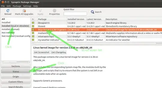

The Synaptic Package Manager can be used to easily select and remove old kernel images. Screenshot of Synaptic Package Manager
If you don't already have Synaptic installed:
sudo apt-get install synaptic
Start the application and select the options shown.
You should be able to highlight all the "linux-" packages with the version "2.6.x" where x is between 31 to 38 according to the files in your /boot folder.
Right-click each of those linux packages and choose the option "Mark for Complete Removal". Finally click the apply button. This will remove all the files and any associated files. Your /boot folder should now be a bit tidier.

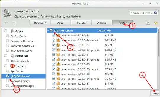

22
Notice that the software in this answer is not supported since 2016. I do not know of alternatives...
This is a new answer to an old question, but an easy way to clean this thing (and more) is to install Ubuntu Tweak. To install it:
sudo add-apt-repository ppa:tualatrix/ppa
sudo apt-get update
sudo apt-get install ubuntu-tweak
then you can run Ubuntu Tweak, Going to the "janitor" tab, and from here it's a matter of three clicks:
Ubuntu tweak janitor for old kernels
It is better to leave the last kernel (you never know) or a well-known working kernel for safety, though; but that's easily customizable.
You can use the same tool to clean a lot of things --- just remember that if you clean thumbnail cache or TB cache then the system will have to rebuild them if they are needed.

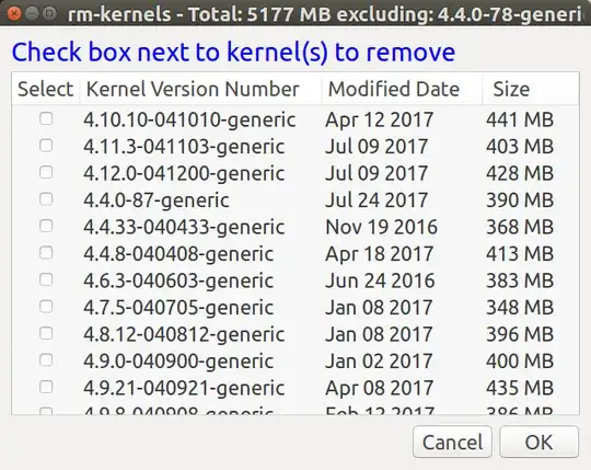

linux-purge utility is made for the purpose:
Install the utility from Launchpad; you can find instructions from there.
