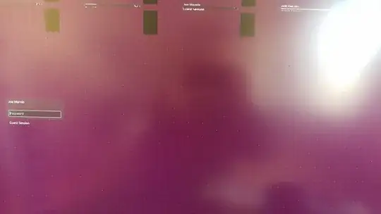

Now, my machine won't boot. I can get to the login screen, but when I enter my password, I immediately get logged out after seeing a glitchy screen like this (sorry for the glare):

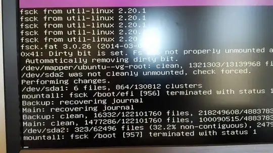

img Trying to boot in recovery mode gives me this output:
img (mountall: fsck /boot [957] terminated with status 1)
It looks like there's a problem with /boot, but I can't figure out how to repair it.

With the help of Byte Commander's comments, I was able to fix this using these steps:
  • Open a root shell in recovery mode
  • Make the filesystem writable: mount -o remount,rw /
  • Mount the boot partition: mount /dev/sda1 /boot
  • Configure a network connection: dhclient eth0
  • Remove unused kernels; this took some improvising, but it was mainly a combination of apt-get purge linux-image-x.x.x-x, dpkg --force-all -P linux-image-x.x.x-x-xxxxxx, and apt-get install -f.
tl;dr: don't let your boot partition get full.
