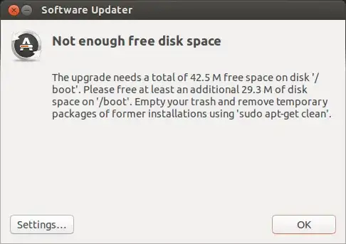

Suddenly this message appears when updating the software.

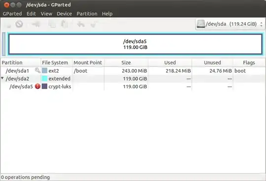

I looked in GParted, and sure enough there is a separate partition with /boot on, which is only 243MiB. This is the first partition, on the drive - all following space is used by the encrypted filespace, which to me means that simply giving the /boot partition more space would be a tough task...
Here's a screenshot of my partitions. Note that this is unaltered from the standard automatic install setup... the only thing I did differently is choose to use full disc encryption.

Try to use apt-get autoremove and see if that removes some of the older kernel packages.
If that does not work, I would suggest you do what I've had to do before, find the kernel you're on now, that's working fine, then use apt-get purge <name_of_older_kernel_package> on the packages for the older kernels.
This will remove all of those older kernels that you are not booting to any longer and may no longer be needed.
