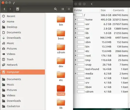

gksudo for Baobab Disk Usage Analyzer doesn't show /boot. I recently removed several old kernels. How can I verify that I've freed up space in /boot?
Backstory — I started spring cleaning because Ubuntu wasn't booting properly without workarounds. I diagnosed the error when my computer warned me that /boot was almost full. The warning opened Disk Usage Analyzer without root permission so /boot wasn't scanned. Now the analyzer can't seem to find the directory at all.

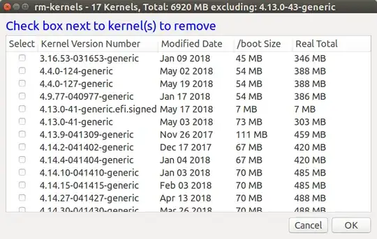

To see how much disk space, not only in /boot but also in /src/lib and /lib/modules each kernel consumes you can use rm-kernels to display storage used without removing anything:
rm-kernels-may2018
In this case there are 6.9 GB used in kernels not only in /boot but across rest of /. The display shows a separate column for how much is used in /boot directory.

If /boot is a separate file system and if you run baobab with sudo, it will not list /boot as part of the full disk analysis. Instead you have to select the file system you want to analyse at the startup screen of baobab.
Alternatively you can run baobab like this: sudo baobab /boot to immediately open the disk usage for the /boot folder.
