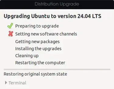

I am trying to upgrade from 22.04 LTS to 24.04 LTS. I am having this problem:
It says:
Error during update
A problem occurred during the update. This is usually some sort of network problem, please check your network connection and retry.
But I don't have any problems with my internet. And I tried both Ethernet and Wi-Fi, and neither works.
I click on "Upgrade Now" button, then it successfully downloads stuff for a while, and then it gets stuck and throws this error.
Then I see this for a moment:
error2
And then it all closes.

I have solved the problem, and I am now currently using 24.04 LTS.
I don't know exactly what worked.
Here are the things that I did:
  1. There was a GPG key issue with GitHub CLI following a recent update, and I solved it following https://github.com/cli/cli/issues/9569.
  2. There was an error message from Brave, saying it doesn't support i386 architecture, so I mentioned amd64 explicitly on brave-browser-release.list following https://askubuntu.com/a/1453449/1030478, and followed installation instruction with the said modification.
  3. Then I followed https://community.frame.work/t/error-while-updating-to-ubuntu-24/57143/6 and tried to upgrade via do-release-upgrade. I saw that my /boot partition was almost full and it needed additional space. I was ready to go with GParted, but, following https://askubuntu.com/a/90219/1030478, I deleted old Linux kernel files, and gained the required space.
After doing all these, by running do-release-upgrade, I was able to successfully upgrade.
It took ~40 minutes.
And on running neofetch, I can see:
OS: Ubuntu 24.04.1 LTS x86_64
For me, this issue is solved, and I am using it right now.
So, I had some problems with updates, and also low space on /boot. After mitigating both, I was able to upgrade to 24.04 LTS using the command line command do-release-upgrade. I was not able to trigger the GUI upgrade window, and did not want to.

I am having the same issue. I have already tried some ways like changing from Download From to Main Server, Server For India not working.
I also have tried with the terminal and found one error:
err https://brave-browser-apt-release.s3.brave.com stable inrelease %0d%0a the following signatures couldn't be verified because the public key is not available: no_pubkey
it seems issue related to brave browser for my case public key is expired or somehting, follow this link https://brave.com/linux/#release-channel-installation this form brave browser official document and try again.
This works for me, and now I am using 24.04
This problem seemed to be caused by a problem with apt not being able to update due to a public key problem. When running sudo apt update, apt would throw the error The following signatures couldn't be verified because the public key is not available: <public key>. I followed the public key update advice here. However, it did not resolve the issue. I just reinstalled the program, and both the apt update and Ubuntu Software Updater errors subsided.
