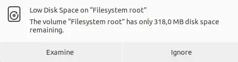

I work in Ubuntu 22 on VirtualBox. /dev/sda3 is almost full:
df -h --total
Filesystem      Size  Used Avail Use% Mounted on
tmpfs           720M  1,6M  718M   1% /run
/dev/sda3        24G   23G  411M  99% /
tmpfs           3,6G     0  3,6G   0% /dev/shm
tmpfs           5,0M  4,0K  5,0M   1% /run/lock
/dev/sda2       512M  6,1M  506M   2% /boot/efi
tmpfs           720M  124K  720M   1% /run/user/1000
total            30G   23G  5,9G  80% -
I have cleared unused linux kernels following How do I free up more space in /boot? which freed only 1%. What else can I do?
I added additional GBs to my virtual hard disk and with GParted added ample GBs to /dev/sda2.
df -h --total now reads
/dev/sda3        25G   23G  115M 100% /
/dev/sda2        11G  6,1M   11G   1% /boot/efi
tmpfs           720M  116K  720M   1% /run/user/1000
total            40G   23G   16G  60% -
Nevertheless I still get an error message "Low Disk Space on "Filesystem root".
What is wrong?
