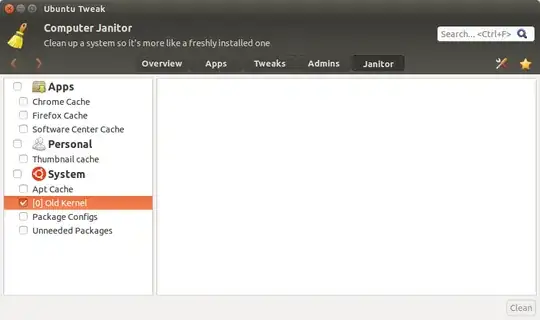

Another easier way, is to install the ubuntu-tweak tool, it can be downloaded from here. Go to "Janitor", and select "Old Kernel" to clean.
