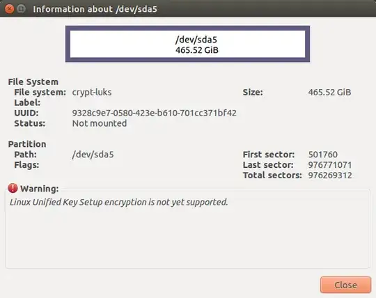

I have 2 partitions. 1 is 255 MB, the other is 496 GB.
This is the warning message that appears in gparted Warning message

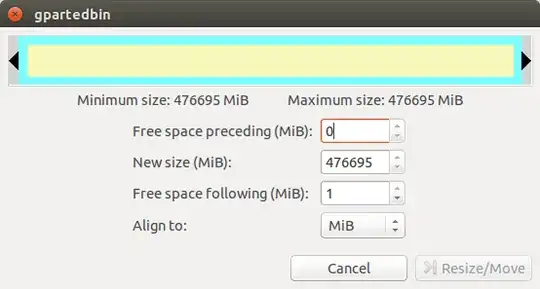

When I click on resize/move for the main partition, the slider bar won't move. Screenshot from gparted
