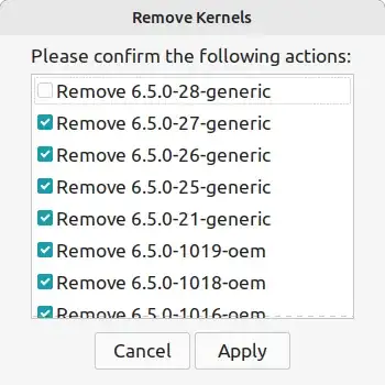

The update manager allows you to delete old headers with the UI. I tried this with the Ubuntu-based Linux Mint:
  • Launch Update Manager
  • Select View | Linux Kernels
  • You'll see a list of installed kernels:
  • You can remove them individually, or (even better)
  • Select Remove Kernels...
  • Adjust the selection as you see fit, although the recommended selection is usually what you want.
  • Voila, you're done!
