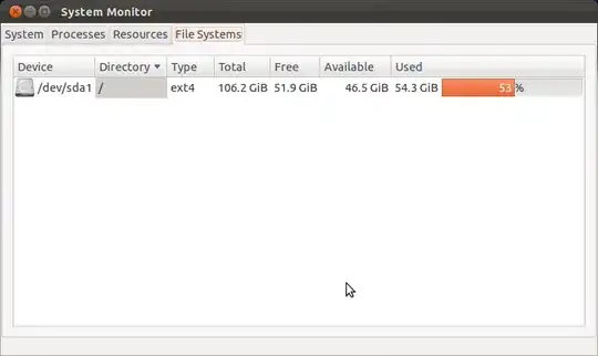

Your errors said:
No space left on device
Open System Monitor from Dash and select the Filesystems tab.
And if the problem is only related to /boot partition try this:
sudo apt-get autoremove
If it didn't work then It seems you have no space in /boot
You've a lot unused kernels. Remove all but the last kernels with:
sudo apt-get purge $(dpkg -l linux-{image,headers}-"[0-9]*" | awk '/ii/{print $2}' | grep -ve "$(uname -r | sed -r 's/-[a-z]+//')")
