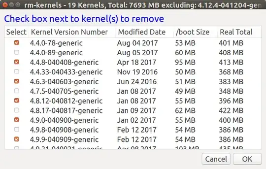

Zenity based solution
Zenity provides a GUI interface to the terminal. Here it's used to process a list of kernels and select individual ones:
The dialog title reports the number of kernels, their total size and the current kernel version booted. The current kernel is excluded from the title's totals and does not appear the kernel list.
The Modified Date is normally the date the kernel was released. On my system that date is "touched" every time the kernel is booted using a cron reboot script (How do you find out when a specific kernel version was last booted?).
For each kernel its size within the /boot directory is reported. Then the kernel's total size is summed for the three directories; /boot, /usr/src/kernel_version and /lib/modules/kernel_version.
If no parameter is passed to rm-kernels the total size is estimated and the title shows "Est. Total". This saves time running the du command which can take 30 seconds to 90 minutes depending on how many kernels you have and whether you have an SSD or an HDD. If you pass any parameter at all then du is used to obtain kernel sizes and the title shows "Real Total" as the sample screen above illustrates.

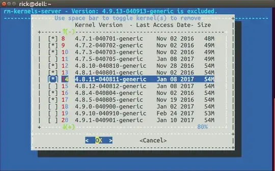

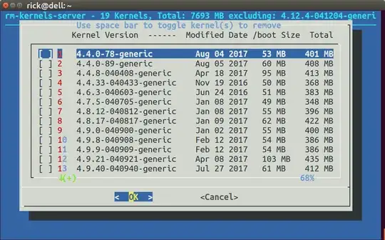

rm-kernels-server is the server version to selectively delete kernels all at once. Instead of a GUI (graphical) dialog box a text-based dialog box is used to select kernels to purge.
  • Before running the script you need to install the dialog function using:
    sudo apt install dialog
Dialog is in the default Ubuntu Desktop installation but not in Ubuntu Server.
Sample screen
rm-kernels-server 1
rm-kernels-server bash code

cmd=(dialog --backtitle "rm-kernels-server - $n Kernels, Total: $t MB excluding: $current_version" \
    --title "Use space bar to toggle kernel(s) to remove" \
    --column-separator "!" \
    --separate-output \
    --ascii-lines \
    --checklist "         Kernel Version  ------  Modified Date /boot Size  Total" 20 70 15)
selections=$("${cmd[@]}" "${SortedArr[@]}" 2>&1 >/dev/tty)

NOTE: In the call to dialog the directive --ascii-lines is passed to replace line-draw extended character set (which ssh doesn't like) with "+-----+" for drawing boxes. If you do not like this appearance you can use the --no-lines directive for no box at all. If you aren't using ssh you can delete the --ascii-lines and your display will be formated with line-draw characters:
rm-kernels-server line draw

The calculated size of each kernel was taken from /boot/*kernel_version* which were 5 files totaling ~50 MB. The formula has changed to include the files in /usr/src/*kernel_version* and /lib/modules/*kernel_version*. The calculated size for each kernel is now ~400 MB.
The default is to estimate the size of files for linux-headers at 125 MB and linux-image at 220 MB because du can be painfully slow unless files are in cached in memory. To get the real size using du pass any parameter to the script.
The total of all kernel sizes (excluding the current running version which cannot be removed) is now show in the title bar.
The dialog box used to display each Kernel's Last Access Date. This date can get mass overwritten for all kernels during backup or similar operations. The dialog box now shows the Modified Date instead.
August 5, 2017 Updates
The kernel list is now sorted by Kernel Version rather than alpha-numerically.
An additional column has been added for /boot size. In the graphical Zenity version the last column changes between "Real Total" and "Est. Total" (Estimated) depending on parameter 1 being passed or not.
