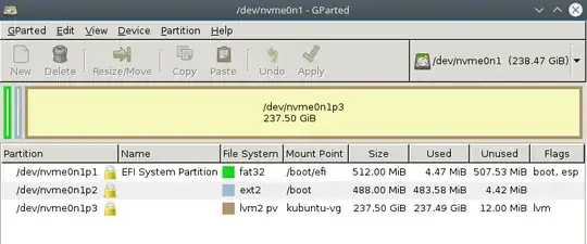

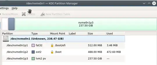

Hoping someone will be able to help me unpick this. I have a 250GB SSD drive with a 488MiB /boot partition that is at 100%. I would like to resize the lvm2 partition to allow me to allocate more space to /boot but this is not working via kubuntu live CD using the KDE partition manager. On my kubuntu install gparted reports that only 12MiB is available however this is incorrect as the results from df -h show. KDE partition manager on the installed kubuntu doesnt manage to report a number for used space.

You need to first shrink LVM logical volumes and only then you can shrink LVM physical volume.
For that you need at least KDE Partition Manager 3.0.x (available in Kububtu 17.04 or various other Live CDs). No version of gparted can resize LVM logical volumes.
P.S. 12 MiB free space is exactly the space not taken up by LVM logical volumes, it is not the free space inside LVM logical partitions.
