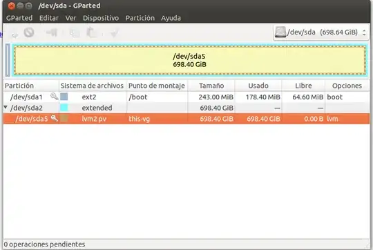

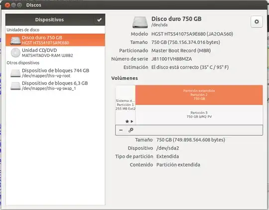

I have problems with system update because my boot disk is too small, but I don't know how to increase this.
I have tried gparted live from a USB drive, but I can not reduce the size of the other partitions. This is my partition table
gparted: enter image description here
drives: enter image description here

gparted does not manage LVM, you have to resize them manually with a live usb.
I suggest you first free up space on /boot , see How do I free up more space in /boot?
If that fails, How can I resize an LVM partition? (i.e: physical volume)
