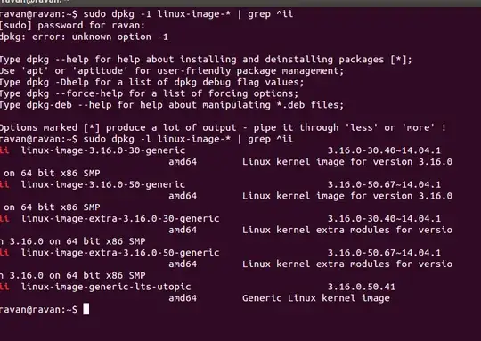

sudo dpkg -1 linux-image-* | grep ^ii
[sudo] password for david:
dpkg: error: unknown option -1
Type dpkg --help for help about installing and uninstalling packages [*];
Use 'apt' or 'aptitude' for user-friendly package management;
Type dpkg -Dhelp for a list of dpkg debug flag values;
Type dpkg --force-help for a list of forcing options;
Type dpkg-deb --help for help about manipulating *.deb files;

From your comment ,you are using 1 instead of l
the correct command is:
dpkg -l | grep linux-image-
Sample Output:
ii  linux-image-3.16.0-30-generic                         3.16.0-30.40~14.04.1                                amd64        Linux kernel image for version 3.16.0 on 64 bit x86 SMP
ii  linux-image-3.16.0-50-generic                         3.16.0-50.67~14.04.1                                amd64        Linux kernel image for version 3.16.0 on 64 bit x86 SMP
ii  linux-image-extra-3.16.0-30-generic                   3.16.0-30.40~14.04.1                                amd64        Linux kernel extra modules for version 3.16.0 on 64 bit x86 SMP
ii  linux-image-extra-3.16.0-50-generic                   3.16.0-50.67~14.04.1                                amd64        Linux kernel extra modules for version 3.16.0 on 64 bit x86 SMP
ii  linux-image-generic-lts-utopic                        3.16.0.50.41                                        amd64        Generic Linux kernel image

I am adding this screenshot to show the difference:
