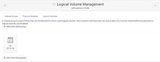

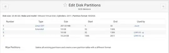

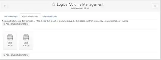

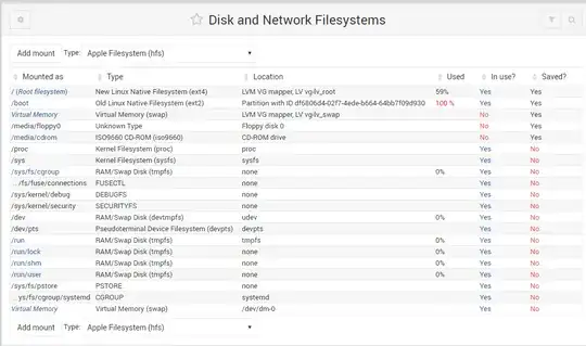

Screenshots from webmin.
partitions
logical volumes
physical volume
logical volumes
disk and network file system

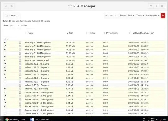

I did delete old kernel files from webmin file manager, so I have more space on boot. I did not try resize process yet.
webmin file manager
After deleting files from webmin file manager then apt-get autoremove worked. apt-get -f install worked. Everything is working good. Thanks everyone.
