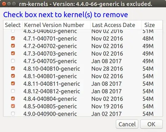

Compared to other GUI answers here, the advantage of this answer is native Ubuntu Bash is used without installing third-party applications.
Zenity and Bash based solution
Zenity provides a nice GUI interface to the terminal to process a list and select items with radio-buttons:
rm-kernels 1
The current kernel you booted with cannot be removed and isn't included in the list. The size reported is how much will be saved in /boot directory. More is saved on your disk because kernel binaries reside in other areas too. July 27, 2017 note: The directories /usr/src/*kernel_version* and /lib/modules/*kernel_version* are now included as well.
The Modified Date is discovered using the stat command. On my system that date is "touched" every time the kernel is booted using this (How do you find out when a specific kernel version was last booted?) cron reboot script. However, on your system the date will be the kernel release date, not the last time you booted it.

The Code
Copy this code to an executable file named rm-kernels in /usr/local/bin:

IFS="$OLDIFS"
i=0
list=""
for choice in "${choices[@]}" ; do
    if [ "$i" -gt 0 ]; then list="$list- "; fi # append "-" from last loop
    ((i++))
    short_choice=$(echo $choice | cut -f1-2 -d"-")
    header_count=$(find /usr/src/linux-headers-$short_choice* -maxdepth 0 -type d | wc -l)
    # If -lowlatency and -generic are purged at same time the _all header directory
    # remains on disk for specific version with no -generic or -lowlatency below.
    if [[ $header_count -lt 3 ]]; then
        # Remove all w.x.y-zzz headers
        list="$list""linux-image-$choice- linux-headers-$short_choice"
    else
        # Remove w.x.y-zzz-flavour header only, ie -generic or -lowlatency
        list="$list""linux-image-$choice- linux-headers-$choice"
    fi
done
if [ "$i" -gt 0 ] ; then
     apt-get purge $list
fi
NOTE: You need sudo permission to create the file so use:
gksu gedit /usr/local/bin/rm-kernels
To make file executable use:
sudo chmod +x /usr/local/bin/rm-kernels
NOTE: For a server (Text based, not GUI) version of this script see: How do I remove old kernel versions to clean up the boot menu?
July 28, 2017 Updates
The calculated size of each kernel was taken from /boot/*kernel_version* which were 5 files totaling ~50 MB. The formula has changed to include the files in /usr/src/*kernel_version* and /lib/modules/*kernel_version*. The calculated size for each kernel is now ~400 MB. The above code for rm-kernels and rm-kernels-server has been updated. However, the sample screens above do not reflect these changes yet.
The default is to estimate the size of files for linux-headers at 125 MB and linux-image at 220 MB because du can be painfully slow unless files are in cache. To get the real size using du pass any parameter to the script.
The total of all kernel sizes (excluding the current running version which cannot be removed) is now show in the title bar.
The dialog box used to display each Kernel's Last Access Date. This date can get mass overwritten for all kernels during backup or similar operations. The dialog box now shows the Modified Date instead.

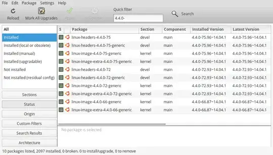

You can easily handle kernels via synaptic package manager. But first you should know the currently used kernel-release name. You can find this out by running uname -r in terminal prompt:
linux@linux-desktop:~$ uname -r
4.4.0-75-generic
So at least this version you should keep untouched. Open synaptic and start filling in quick filter placeholder as shown below:
quick filter search box at top in synaptic
Now you can select all packages which you wish to delete and do:
Mark for complete removal > Apply
I would suggest to keep at least a latest current kernel package and one previous kernel. For instance in this case you can safely get rid of linux-image-4.4.0-66-generic and linux-image-extra-4.4.0-66-generic, but it would be good to keep 4.4.0-72 and of course 4.4.0-75.
