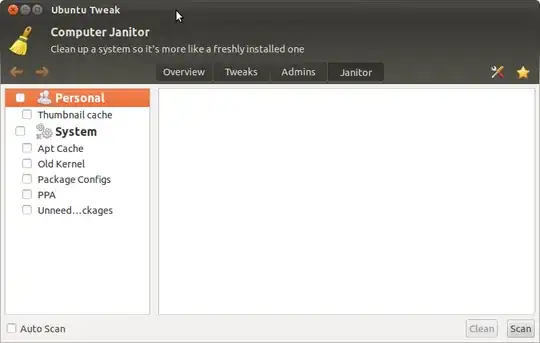

You also have the tool Ubuntu-Tweak:
sudo add-apt-repository ppa:tualatrix/next
sudo apt-get update
sudo apt-get install ubuntu-tweak
Then run ubuntu-tweak. It has an option for cleaning up called Janitor:
Lastly you have Bleachbit (Or ChlorineByte ^^) which has several FEATURES which include cleaning the cache from Firefox, Temp files for more than 50 programs and other stuff that is mentioned in the Features page.

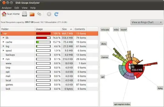

You can use disk usage analyzer to see what is using space. It is installed by default.
You should not delete things outside of your home directory unless you know what you're doing. Before you delete things, it is a good idea to rename them to see if everything still works. When you know that it does, then you can safely delete them.
