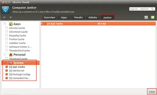

To prevent future 'no space in boot/' errors, install ubuntu-tweak and use it's janitor to do frequent cleanups of your cached programs, old kernels, unneeded programs, etc.
After installing, go to "janitor" and check the "system" checkbox in the left sidebar and then press "clean" at the bottom. Check image below.
Ubuntu tweak showing janitor
