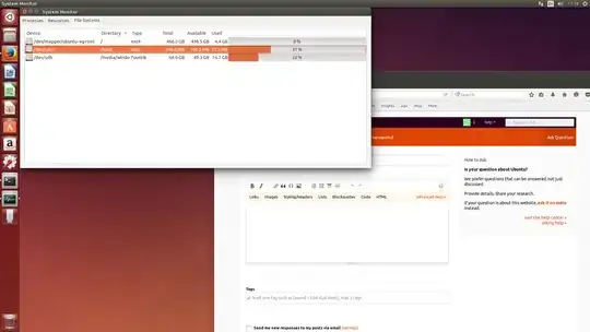

I'm pretty new in managing space in Ubuntu.
I attached the screenshot of system monitor from my PC.
What does /dev/sda1 is related to ? I see the space alloted to it by default is very less. Is there a way I can increase the space for that partition to avoid any problems in future?

/dev/sda1 is your boot partition, you don't have to increase it. Your main partition is /dev/mapper/... and that's lots of space, but in case you need more space you can another HDD and increase the size of it using LVM since you have it enabled.

As mentioned, /dev/sda1 is your boot partition, the primary partition that contains the boot loader.
To increase space in boot you need to shrink another partition and free space. Use gparted tool on the live cd to do this but please, always backup your data. On gparted decrease the size of / and then increase the size of boot. Try following this guide: How to resize partitions?
Alternatively, you can free space on /boot following this guide here:
How do I free up more space in /boot?
