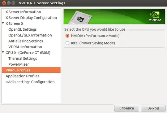

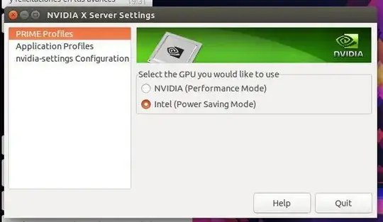

Computer with two video cards in hybrid mode
Starting with Nvidia 319.xx, both Nvidia Optimus and the common PCIe drivers are integrated into one, so if you install the Nvidia-319 package or newer, you will get the driver for the Integrated Nvidia cards and also for the PCI ones.
There are two solutions possible for hybrid cards: The first one is a package called bumblebee, which is able to use different configurations for different applications. To install it, run:
sudo apt install bumblebee linux-headers-generic
The second one is an official NVIDIA package called nvidia-prime, which is automatically installed together with the nvidia-355 package. It is able to decide on which card to use at profile level, i.e. when the user logs in. This decision is adjustable at NVIDIA X Server Settings Control Panel. Note that nvidia-prime and bumblebee are incompatible: If bumblebee is installed then nvidia-prime won't function correctly, and its options won't be shown at NVIDIA X Server Settings Control Panel. You'll have to 1. remove bumblebee 2. reinstall nvidia-430 in order to make it work again.
After this, it is recommended to turn off the computer and then back on.
The following picture should be seen with nvidia-prime installed, but not necessarily when bumblebee is also installed.

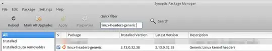

NVIDIA (old drivers that need the headers)
For Nvidia, many times you need to first install the header files of the kernel version you are using at that moment for the driver to install correctly. So you would first need to execute the following line:
sudo apt-get install linux-headers-generic
And then install the package related to the driver (nvidia* for Nvidia cards). In other cases you might need to go a little further and install the sources and specific header files, for example:
sudo apt install linux-source linux-headers-3.5.0-16-generic
which installs the linux-source package and the specific header file assuming you have in this case the 3.5.0-16-generic kernel version.

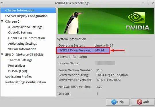

To check which version you have at any given time type uname -r which should give you the specific kernel version in use.
For Nvidia, it depends on the video card and package needed for it, for the latest video cards and assuming you added the PPA mentioned above, the terminal line would be:
sudo apt install nvidia-driver-440
The number at the end would change depending on how old your video card is or how new it is (Some versions available are 390, 410, 415 and 418).

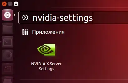

The latest versions bring more fixes and correct issues related to graphics corruption, HDMI support, thermal support and more for the latest Nvidia cards. Normally, updating the video drivers solves many issues.

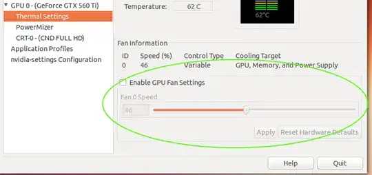

Note that Fan Control and any other Nvidia features that are not found on the nvidia-settings app, are not Ubuntu related, but Nvidia related. I would recommend, asking the Nvidia developers in the official Nvidia forum about features you may want to include (Fan Control, Overclocking features, etc...)

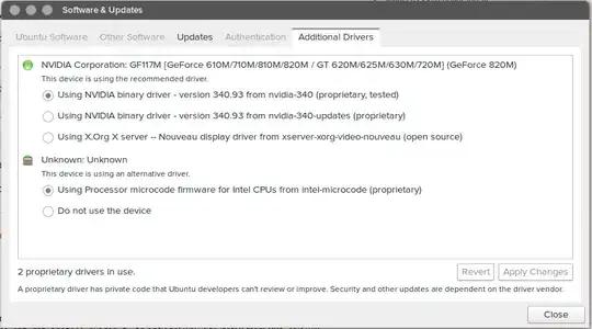

2.6 Difference between Proprietary Drivers?
Please visit Difference between Additional Drivers (Nvidia) for more information about Proprietary Drivers.

For Nvidia Video Cards follow these steps:
  1. In the terminal type: sudo nano /etc/X11/xorg.conf
  2. Find the device section and add the following line:
     Option "Coolbits" "4"
it should look something like this:
 Section "Device"
     Identifier     "Device0"
     Driver         "nvidia"
     VendorName     "NVIDIA Corporation"
 EndSection
Now save and reboot. You should now see (Depending on your video card model) a new option about Fan Speed like this:

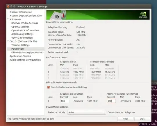

A brief explanation of CoolBits:
CoolBits enables various unsupported features, such as support for GPU clock manipulation in the NV-CONTROL X extension. This option accepts a bit mask of features to enable. Which means a value of 0, 1, 2 or 4.
CoolBits = 1 - When "1" (Bit 0) is set in the "Coolbits" option value, the nvidia-settings utility will contain a page labeled "Clock Frequencies" through which clock settings can be manipulated. "Coolbits" is only available on GeForce FX and Above.
CoolBits = 2 - When "2" (Bit 1) is set it will attempt to initialize SLI when using GPUs with different amounts of video memory.
CoolBits = 4 - When "4" (Bit 2) is set the Thermal Monitor page will allow configuration of GPU fan speed, on graphics boards with programmable fan capability.
The default option is 0 (unsupported features are disabled).
As of Nvidia 337.XX the following options are available:
CoolBits = 8 - When "8" (Bit 3) is set the PowerMizer page in the nvidia-settings control panel will display a table that allows setting per-clock domain and per-performance level offsets to apply to clock values. This is allowed on certain GeForce GPUs in the GeForce GTX 400 series and later. Not all clock domains or performance levels may be modified.
CoolBits = 12 - When "12" (Bit 3 + 2) this will be the same as activating the effects of Coolbits 8 + Coolbits 4. So you will get the new overclocking features and fan control.
This options can also be activated by issuing the following command:
nvidia-xconfig --cool-bits=4
WARNING: this may cause system damage and void warranties.

You don’t need to use command line nor software centre to install NVIDIA drivers (also its best not to install it this way because sometimes you may boot to black screen.).
Ubuntu comes with NVIDIA drivers pre-configured (but not installed), all you need to do is:
  1. Open dash
  2. Search and launch Additional Drivers, wait for it to search, then select the driver you want to install. It comes with 2 drivers, one is open source Nouveau and proprietary from NVIDIA.
  3. Select the driver, press Apply Changes and wait. It may require some time and internet connection for it to download and install it for you.
  4. Now reboot.
I have selected the proprietary drivers

The recommended way is to install the drivers from Ubuntu repositories.
Now all Nvidia adapters are supported by the drivers included in Ubuntu repositories. But this was not always the case and in the future some new adapters may appear that will not be supported by the Ubuntu official drivers for a while.
In most cases the system picks the correct driver in
System Settings -> Software & Updates -> Additional drivers.

To check which proprietary driver is installed run:
dpkg -l | grep nvidia
The package marked with ii is installed.

Hybryd graphics
If you have a laptop with an Intel CPU, in most cases you will have also an Intel adapter that is built in CPU.
In this case you will have to install nvidia-prime package too. But if you install from the official repositories, it will be installed automatically.
Then you will be able to switch adapters in Nvidia X Server Settings (PRIME Profiles).
Or you can do it in terminal.
  • sudo prime-select nvidia will switch to the Nvidia adapter.
  • sudo prime-select intel will switch to the Intel adapter.
  • prime-select query will show the current state.
You will need to log off and log on to apply the setting.

Install linux-source + linux-headers-generic + dkms (Using Synaptic Package Manager)
enter image description here enter image description here enter image description here

  • To adjust your NVIDIA settings Type: nvidia-settings

The problem you're running into is that you don't have the linux source, so you can install the nvidia driver. I believe what you want is the linux headers for your kernel version.
sudo apt-get install linux-headers-generic should install the correct headers, which then will allow you to continue from where you left off.
