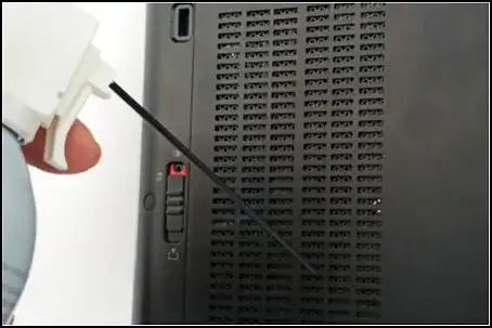

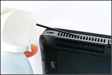

Step 1: WHERE ARE MY VENTS?

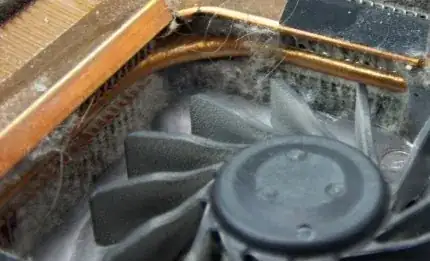

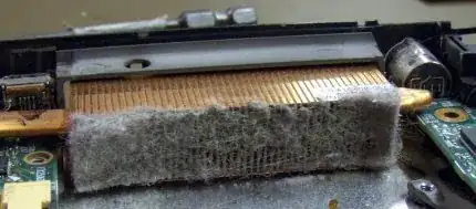

Most notebook computers have vents located around the case to allow air to flow through the case. If these vents become clogged, or if heat-generating parts become covered with dust, the fan cannot cool the components properly, because the laptop is hot and overheating becomes a problem. Lint and dust accumulation prevents air from flowing around the cooling fan blades and causes the fan to work harder and the laptop to get hot. If there is dust in the vents, you should clean the laptop by blowing out the dust from around the fan and heat shield. This prevents dust from accumulating. It is not necessary to open the notebook (laptop) to clean out the dust with the canned, compressed air. The following graphics show the dust accumulation on the inside of the laptop, but dust around the fans and heat shield of the laptop can be cleaned without opening the computer.
Figure 1: Dust Accumulation
Figure 2: Dust Accumulation around a vent
Figure 3: Side Vents
Figure 4: Bottom Vents
