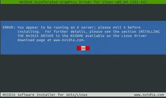

I have a Nvidia Ge force Ge6150 SE graphics card. I am running ubuntu 12.04. When I try to install the .run file it fails. It shows the message like this:
I tried to install it after uninstalling the old driver.still same message. Here is the log file:
nvidia-installer log file '/var/log/nvidia-installer.log'
creation time: Mon Jun 11 05:46:17 2012
installer version: 295.53
PATH: /usr/local/sbin:/usr/local/bin:/usr/sbin:/usr/bin:/sbin:/bin:/usr/games
nvidia-installer command line:
    ./nvidia-installer
Using: nvidia-installer ncurses user interface
-> The file '/tmp/.X0-lock' exists and appears to contain the process ID '1062' of a >runnning X server.
ERROR: You appear to be running an X server; please exit X before installing.  For >further details, please see the section INSTALLING THE NVIDIA DRIVER in the README >available on the Linux driver download page at www.nvidia.com.
ERROR: Installation has failed.  Please see the file '/var/log/nvidia-installer.log' >for details.  You may find suggestions on fixing installation problems in the README >available on the Linux driver download page at www.nvidia.com.
but no such file is shown in the process manager.

As the error states, you are still running an X server. This error occurs when you try to install the Nvidia .run files while logged in.
Make sure you are logged out.
  1. Hit Ctrl+Alt+F1 and login using your credentials.
  2. kill your current X server session by typing sudo service lightdm stop or sudo lightdm stop
  3. Enter runlevel 3 by typing sudo init 3
  4. Install your *.run file.
    1. you change to the directory where you have downloaded the file by typing for instance cd Downloads. If it is in another directory, go there. Check if you see the file when you type ls NVIDIA*
    2. Make the file executable with chmod +x ./your-nvidia-file.run
    3. Execute the file with sudo ./your-nvidia-file.run
  5. You might be required to reboot when the installation finishes. If not, run sudo service lightdm start or sudo start lightdm to start your X server again.
  6. It's worth mentioning, that when installed this way, you'd have to redo the steps after each kernel update.
