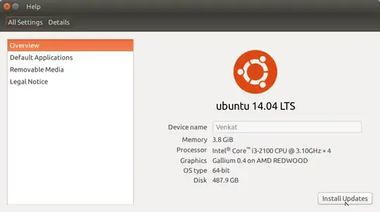

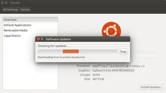

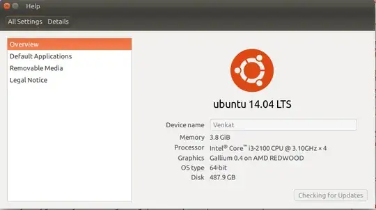

First, make sure your Ubuntu OS is up-to-date. To check this, click the power icon in the top right corner. From the menu select 'About this computer'. Now check if there is an 'Install updates' button (it might appear after a few seconds after the 'Checking updates' button) which can be used to update as shown below. If not, your system is up-to-date.
(First you might see this) enter image description here
(Then this) enter image description here
(After pressing 'Install Updates' you will see this) enter image description here
One may also resort to using the terminal command as shown below to update:
sudo apt-get update && sudo apt-get upgrade

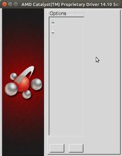

4: Also don't be startled if your driver installer appears like this (without any text):
In this case see the installer notes and with the help of the screen shots provided there install your driver.
