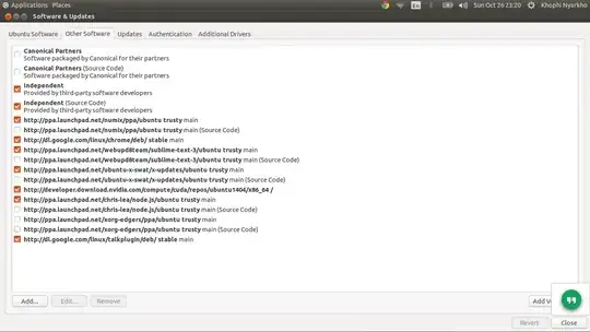

Blow xorg Edgers ppa away
In your "Other Softwares" tab, uncheck the Xorg Edgers PPA, to look like in below image. That ppa caused me so much pain than good.
Uncheck xorg edges ppa in
Then allow the packages to be updated when prompted to or let ...

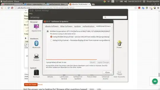

Go back to additional drivers, and you should see only one Nvidia binary listed (at least for my card, that's what was listed, instead of the two that showed when the xorg edges ppa was active )
What was/is the difference? The drivers showed by the xorg edgers ppa are open source. The one which now shows has the indication proprietary. In this case, proprietary rocks, so please go with it, unless you wanna mess your head around for the next hours without success.
Switch from the x.org x server to the nvidia binary and apply. It should take a bit of time to apply (it took a bit of time on my end here, and I realized it downloaded some packages in the process). Restart your computer when its done.
