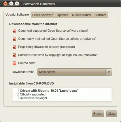

You can enable the repository from the command line or graphically.
Graphically
Open Software center, navigate to the "Ubuntu software" tab at the top, select (check off) multiverse.
Software Center
Use the "Reload" button to update your package list.
Reload
Note: This is called "Software and Updates" in recent versions (e.g. 20.10) of Ubuntu.
