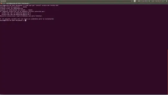

When I run
sudo apt-get install nvidia-smi
I get
The nvidia-smi package is a virtual package provided by:
  nvidia-387 387.34-0ubuntu0~gpu16.04.2
  nvidia-384 384.98-0ubuntu0~gpu16.04.1
You need to explicitly select one to install.
How do I choose one of these two to install?
screenshot

You choose one package or the other by supplying the package name to apt-get:
sudo apt-get install nvidia-387
or
sudo apt-get install nvidia-384
See https://askubuntu.com/questions/61396/how-do-i-install-the-nvidia-drivers
