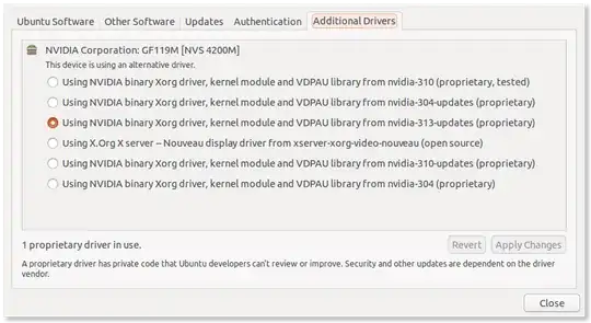

Install latest nvidia drivers
sudo apt-get install nvidia-313-updates
Enable nvidia drivers to manage your graphics
sudo nvidia-xconfig
Then execute
sudo software-properties-gtk which will show you a window like this
and select the latest driver from that list.
And then do
sudo reboot
