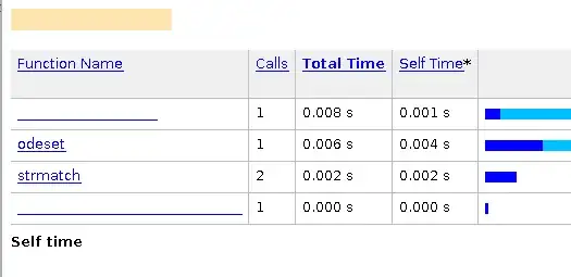

I'm having various issues with rendering text in Matlab 2016b after doing the upgrade to 16.04. Here are some example screenshots:
Glitching in menu
Invisible text in profiler
I have already checked the classic Ubuntu issue with sub-pixel anti-aliasing causing text to disappear, but this does not seem to be the issue.

Anyone have any idea what could be causing this?
From the output of the lshw command, I can safely conclude you forgot to install the nVidia drivers...
So have a look here on how to install them and then the problem will go away!
Fabby
  • 35,017
For those of us who don't happen to have a spare NVIDIA card lying around: I think the problem is related to the Intel driver and can be fixed by enabling antialiasing.
Enabling font antialiasing in MATLAB:
Select Preferences -> Fonts -> [x] Use antialiasing to smooth desktop fonts (requires MATLAB restart)
